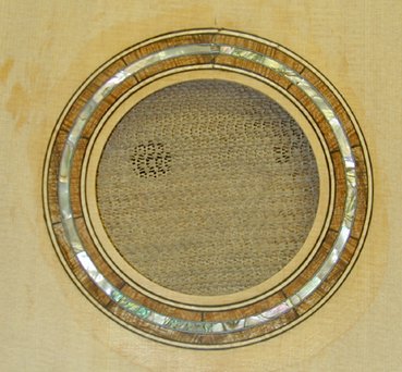

Here are a couple I just did, both are red ab, the koa one has shell I made, about 130 thou wide, the braz one is 1/16 curved strips, same radius was used for both rings - works fine.

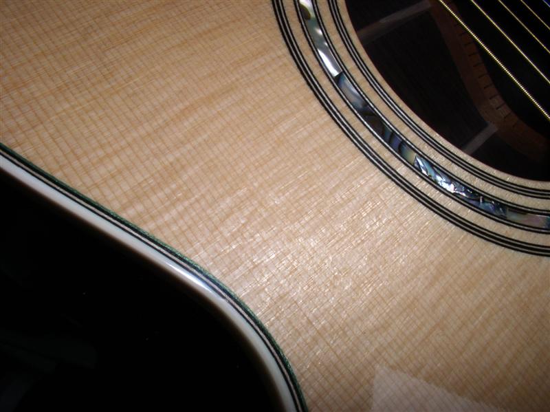

PostPosted: Wed Apr 12, 2006 7:30 am
and the braz one, double rings ..
